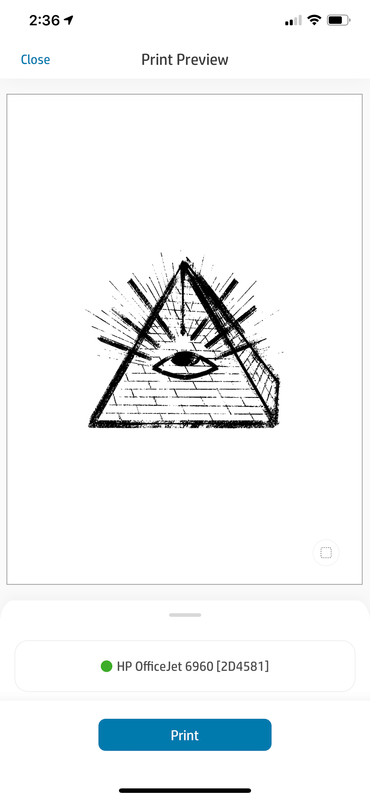

I've never had an issues printing on different types/styles of paper in the 2 years I've had this printer. Until, I tried printing on 5x7" (kraft paper) cardstock. The image comes out different every single time. Off centered, cut-off at the top of the paper, you name it. There is no rhyme or reason as to how it's going to print. I have gone through all of the troubleshooting steps as directed by HP, and am still coming up with the same issue. The only thing I haven't done is installed a new ink cartridge (which a new one will be here in a few days). However, I don't see how this is an ink cartridge issue...as my 4x6" sticker labels, standard size 8.5"x11" printer paper, AND 8.5"x11" cardstock printer paper all print correctly and centered. HELP?!
How it prints versus how the print file looks on the print preview via the HP Smart App on an iPhone.
