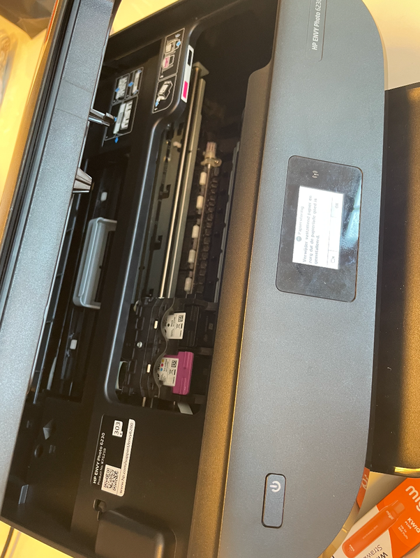

My printer is an HP Envy 6230.
My paper got stuck in my printer and I pulled it out.
I thought everything got out but it keeps on saying ‘paper jam’.
I turned the printer upside down to check everything and there is no paper left. I also checked the inside (as far as I can get) to see if I can see anything…but nothing.
The printer does make a weird sound once it try to print something. Maybe it's the ink carriage that is locked?
Can someone please help me.
after it says 'paper jam'after it says 'paper jam'

@ByVeer
Let's try to reset the Printer here:
Reset the product
  • With the printer turned on, disconnect the power cord from the rear of the printer.
  • Unplug the power cord from the wall outlet.
  • Wait at least 60 seconds.
  • Plug the power cord back into the wall outlet.
  • Reconnect the power cord to the printer.
  • Turn the printer on. HP recommends plugging the printer directly into a wall outlet.
Also, try connecting the Printer to a different wall outlet directly.
Also, try a firmware update: https://support.hp.com/in-en/document/c02919168
Let me know if this helps.
