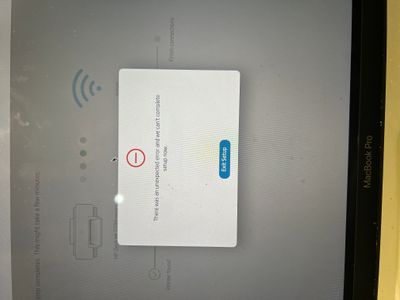

I have factory reset my printer and also wifi reset it as it used to be connected to an old wifi. When I try connect it to my new wifi after having reset it multiple times, it won't connect. I use the HP app on my laptop (mac) and it stays on wifi diagnostics for ages then fails to connect and tells me there is an error. The screen on my printer read "0", whatever that means. Please help as I really need this working for Uni.

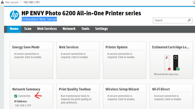

If your printer is connected to the same wifi as your PC, then type the IP address from the configuration page in your PC browser address bar, and accept any security warnings. You should enter the printers embedded webserver:
Check connection status and for messages especially under network and settings.

This is where it gets to
You actually are connected to the printer. That is nice. Something works.
I assume you have typed the password of your new wifi, but the printer cannot connect to this wifi.
