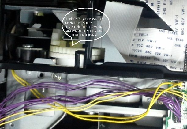

BU DİŞLİNİN SIKIŞMASINDAN KAYNAKLI BİR SORUN ELLE BİR TUR ÇEVİRİSENİZ BU DERTTEN KURTULABİLİRSİNİZ

Something bad and not an easy job to fix it.
There's a sticky solenoid causes the black/color match timing wrong.
If you can just clean the sticky thing off it will fine and put a piece paper inbetween will be better.
Not an easy job to do.
Check here on youtube, not same models but same problems.
Hp CLJ CP3525 CP3530 59.F0 disassembly
https://www.youtube.com/watch?v=Ak8hkSuRyOk
HP LASER JET COLOR CM1415FN ERRO 59.c0 PARTE1
https://www.youtube.com/watch?v=qOc7T4zo-uQ
Important: 25min 40sec white gears position. Remove the brown sponge from the solenoid and glue there a thin plastic piece. CM4540 is very similar. UPDATE!!!: I found an other video about this issue which is much more simple: https://www.youtube.com/watch?v=kE1YhZXxLp0 I haven't tried it in that ...
By the way, there's no need to take motor and gears assembly off , just use Q-tip and alcohol will be done.
But the solonoid is hiding in deep of the gears not easy to be found.
You can check it by seeing  Replies (12) 's picture it's rery close to where it is.

It's caused by so called sticky solenoid which seat behind formatter, ADF......
Not so easy to get to it. You need to take out ADF,left,right,upper case.... first.
http://westhillprinters.blogspot.com/2011/12/sticky-solenoids.html
It controls black color and the other three colors (at the same time)to work with each other.
But because of sticky problem you got 59.C0 error.
What you need to do is to resolve the sticky solenoid issue.
Not an easy job to do but it's not so difficult either.
No need to really take apart everything before you to get to it .
What you really need to do is making a piece of V shape of paper its dimention maybe is 0.3 * 1.2 cm.
And find some ways to insert it into and between the solenoid's two metals to prevent the sticky issues happens again.
It will always has a small hole between gears and plastics. Find it out and insert the V shape paper into it.
After done that you will be fine.
You need a thin paper don't make it too thick!
