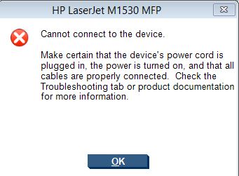

Thank you he suggestions by you. I tried these but it does not work.
May be I could not explain my problem.
I have uninstalled and reinstalled the printer with the accompanied CD.
The following problems occur.
1. Printer is not detected by HP ToolBox FX, it says " Cannot connect to the device", when opened it shows a cross (X) on the printer..
2.  I can not change the printing preferences of the printer from the control pannel neither through any other software.
3. I cannot run the HP Fax Setup Wizard and HP Send Fax utilities.
But I can still print and scan using this printer.
I am confused and request for help.
Best regards
Latif

Hello again Lil_Lisa27,
Following the steps recommended by you, I was able to succefully install the HP 1536dnf MFP on Windows 8.
But recently when I upgraded to Windows 8.1, my printer driver was removed while the Fax and Scan drivers were still intact.
After that I have tried several times by uninstalling and reinstalling the software from the original CD but I endup with an error message during detection of the device as shown below.
Kindly advise me what can I do to install the printer again in Windows 8.1.

Hello Lil_Lisa27,
After uninstalling and installing several times finally I am able to successfully install the software. However, after successful completion of the software, I am unable to use the Fax and HP ToolboxFX.
The following message appers when activating the ToolboxFX.
And the following message appears while activating the HP Send Fax utility.
I would again request your help.
Best regards
Latif
