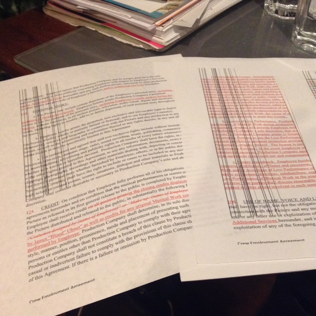

When I print using colored ink, there are black vertical lines printing on the left side of the paper. It does not seem to happen when I am printing on black and white ink. All my cartridges are from HP and I made sure to align them after installation. What could be the problem? This printer is only four months old.Black vertical lines on page

From the picture you have provided it looks as if the vertical lines are fairly uniform. It might help to clean the printer rollers and ink smears.
