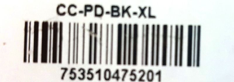

Thanks for the reply.   The here is the barcode I am testing with.  It will scan with no problem.

The first three 'characters' of the bar-code, as highlighted here:
are:
  • Start-C - this control character indicates that the bar-code should start using the 'subset C' encoding (which encodes pairs of digits).
  • FNC1 - this function code "indicates that it begins with a 2- 3- or 4-digit application identifier assigned by the Uniform Code Council" - for example (according to Wikipedia), the U.S. ZIP code for the White House would generally be printed as "(421) 840 20500", but would actually be coded as "[Start C] [FNC1] 42 18 40 20 50 [Code A] 0 [Check symbol 92] [Stop]"
  • 75 - this is the first digit pair.
So the problem is one of interpretation.
NotePad presumably knows nothing about the meaning of the non-graphic FNC1 control-code, so interprets it as best it can (as a graphical representation of a control code).
i.e. your bar-code is a special type of Code 128 bar-code, now (apparently) known as GS1-128 (previously known as UCC-128 or EAN-128 bar-codes).
So if you can program your scanner to interpret it as this type of bar-code, you may get a different output (possibly with parentheses around the Application Identifier digit(s).
