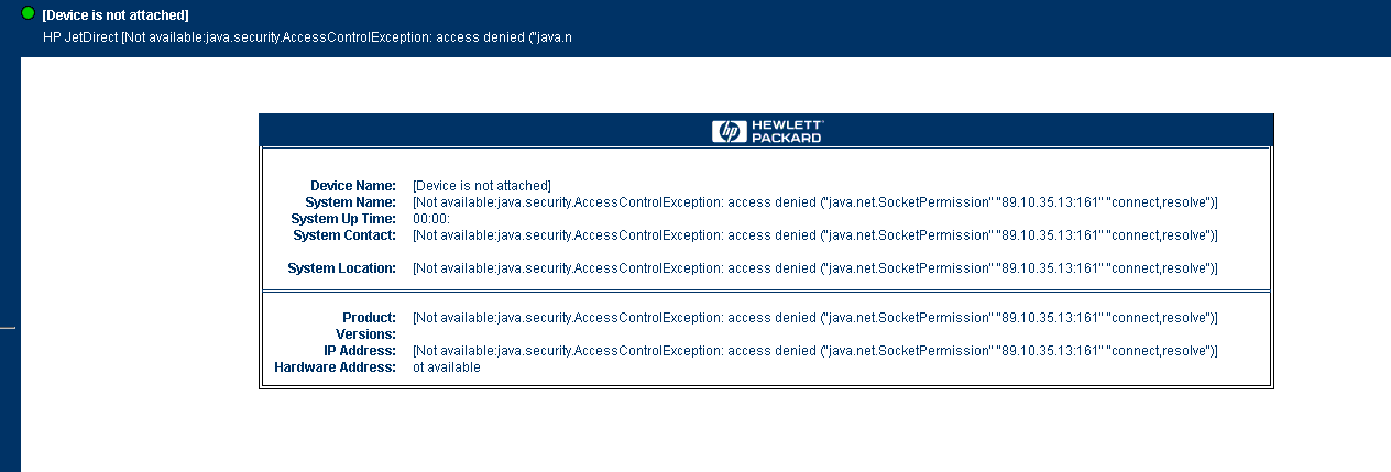

Hi,
since years I try to configure my 2100tn on my  home network, but never made it and always gave up... this time i managed to get into the browser config page of the printer but... Some plugin is missing (if I go there on win xp) and on mac it states that macintosh is not supported?
"Macintosh OS is not supported to run this application."
Is there any solution to change the ip? Its set to some very uncommon one, because it used to be a printer in a big business network...but i would love to keep using it, because its a great printer.+
any ideas?
now i managed through installing jre 7 on the virtual xp machine but...
