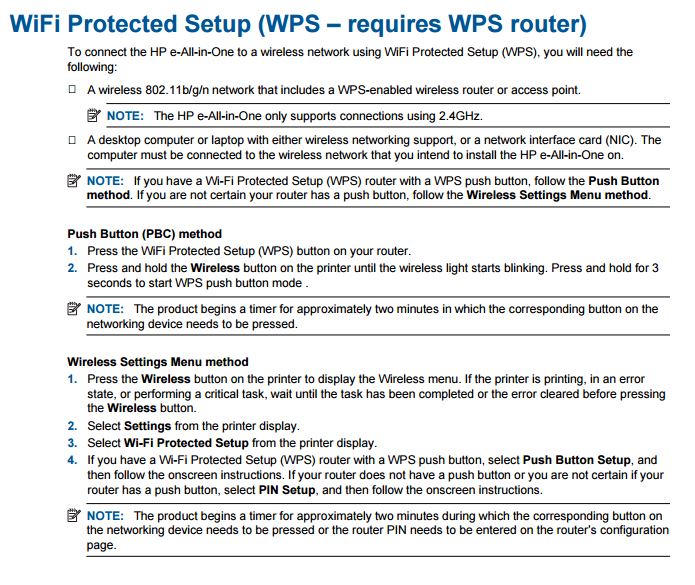

I did some research and located the user guide (Page# 33) for the printer. It contains detailed steps to connect the printer via WPS and PIN setup.
I hope this helps. Let me know what happens. Thanks for your patience. Cheers! 🙂
So, I really do appreciate the help. But I am not sure where I am missing to make myself understood. In the last line of my last post I stated that the printer will not connect if there is a password, even via WPS or pin.
I have looked through tons and tons of forum posts, HP documentation, help files, trouble shooters and googled til I can google no more. I have done all standard instructions and reset everything I can reset.
If there is a password on the wireless connection, the printer refuses to accept the password, refuses to connect via WPS, refuses to connect via PIN. The printer is, for some unknown reason, not able to see the password as correct or accept the connection via any other method. Need help!
