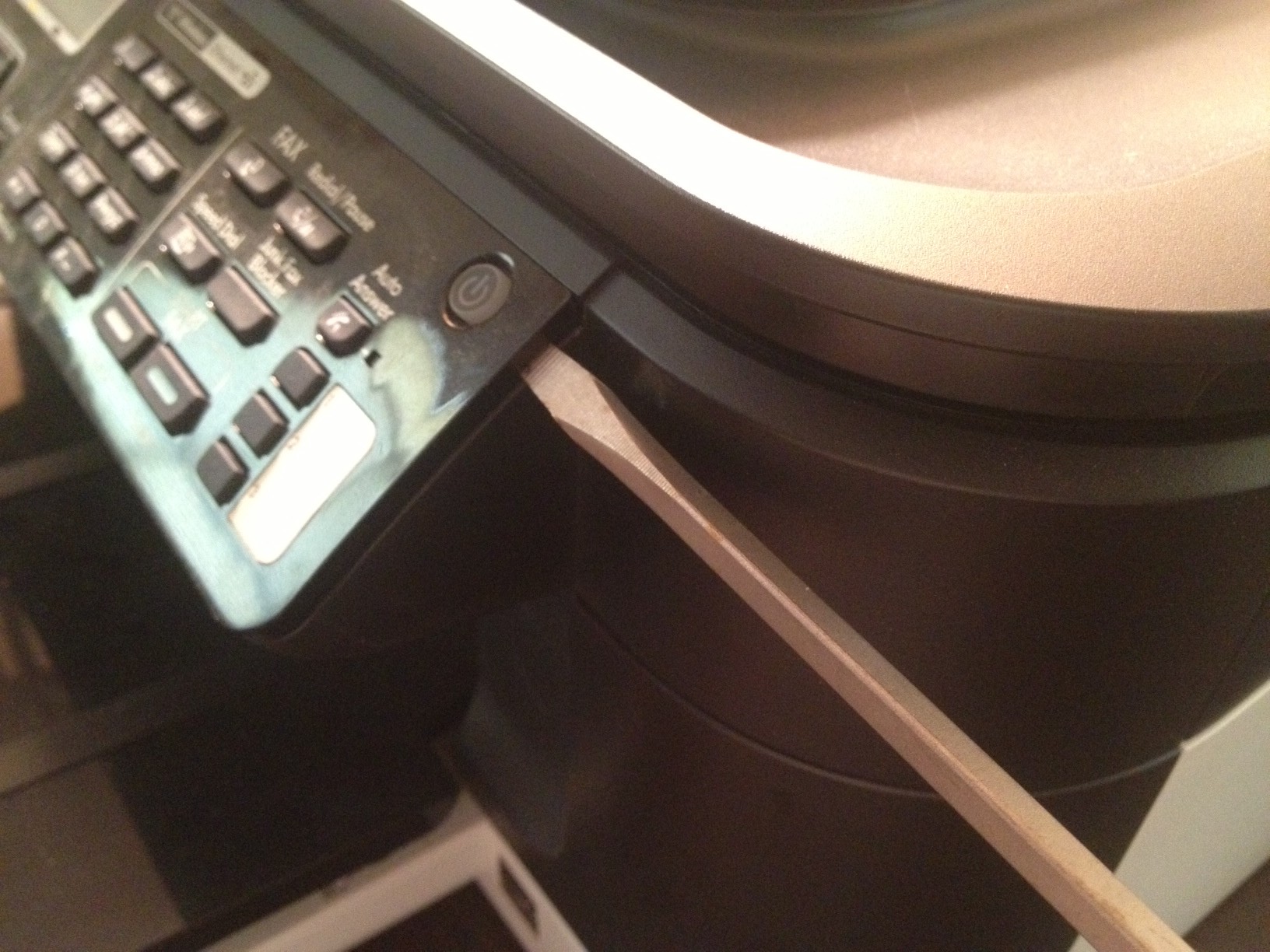

Step 1: Use flat head screw driver to remove cover plate.
Step 1 - Use flat head screw driver to remove cover plate

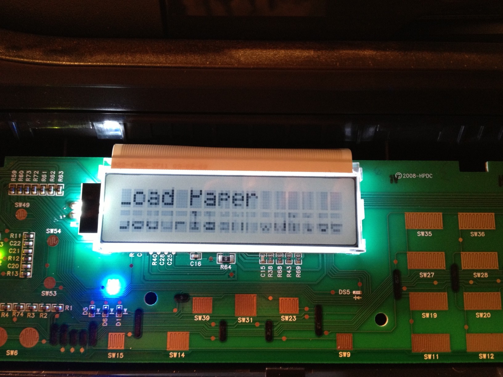

NOTE: Got about half way through and wanted to see the difference.  Before I started, my client had 6... yes only SIX vertical sets of pixels display on the LCD (out of the 80 total vertical sets for the display, 16 sets of 5).  I reconnected the ribbon cable to the circuit board and plugged the power into the printer.  WAHOO!! I can see something actually legible!!  So I disconnected the power, removed the ribbon cable, and kept going on the rest of the pins.
After pushing down the rest of the pins, I ended up with something that was FAR more readable than what I started with.  There was ZERO that could be read on the screen before.  No I'm getting somewhere.
Could still be better though....

NOTE:  After doing that, I hooked the circuit board back up to the printer just to see the difference:
YES!  TOTALLY usable now!  Not perfect!  But still way better than having to chuck the printer or not read the screen AT ALL!!!
