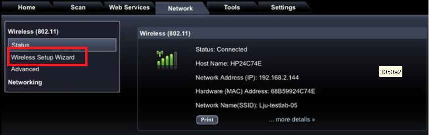

  2. Load up the Embedded Web Server (EWS) in the browser on your mobile device or computer. The default IP for autowireless is 192.168.223.1.
  3. Go to the network tab along the top of the EWS.
  4. Click on Wireless Setup Wizard along the lefthand side to begin configuring the printer.
