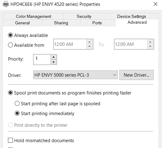

2. Select the HP Envy 4520 printer and select either "Manage" or Properties. You want to be editing the Printer Properties.
3. You will see a screen like this,
4. Click on "New Driver" and you will click next and select check windows update.
5.  I will check windows update which will take a minute or two and then you will select HP from the left screen and scroll down to find "HP ENVY 5000 series PCL-3"
6. Click next to install. Once that's done it will show on the previous screen (The first picture I posted).

I was so hopeful! I have a different setup though, and I wasn't sure how to assign that driver specifically to the printer.. It won't let me click 'apply' and the properties aren't helpful either. Hmmm
Oh, I got it assigned, but it didn't work 😞
When you look at the printer properties does it say the 5000 driver is selected? I am still testing this and it worked fine in color mode but black and white for some reason it started not printing out the black text. Can you confirm the same thing happens to you? I will keep working on it!
It does say the 5000 driver is selected now. I changed my document to color, and it printed a thick not-straight line of dark blue, which is more than it has been printing, but it didn't print anything else...
