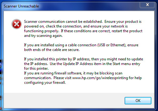

I have the same problem. All of a sudden today, my ability to scan using the desktop icon has stopped.  I get the following message:
I've rebooted the laptop and the printer several times but to no avail. Also, have moved the USB physical connection around to different USB ports. BTW, the laptop (HP) is on a docking station and physically connected to the printer via a USB cable.
Appreciate any help!
