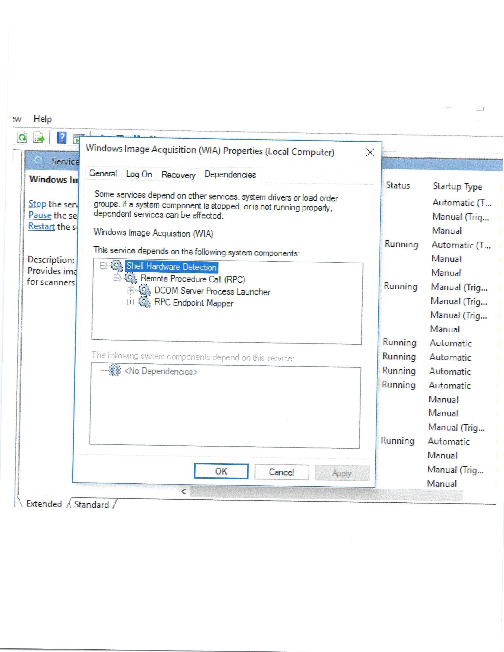

it actually put the RPC under the Shell Hardware Detection
I restarted my computer and tried to scan from printer to computer it said preparing to scan and after awhile it came up "connection unseccessful" like it has been.
Under the service Windows Image Acquisition (WIA) properties, can you see both the services listed now?
Is the sertice startues is Started?

so it doesnt give me a chance to, here are what to 2 different screens look like.
I did a test print to check to make sure atleast that was still good and now it is printing slow like it is doing a photo. I went back to the backed up registry,  I have rebooted both and it is still doing it and it is still pinting slow.
Hi,
Please repeat my previous poss (it should already be highlighted on the stisvc service so you would only need to modify the DependOnService value.
Be sure to change it exactly as listed on step 6 by copying ad pasting the value from the shown sample, the order is crucial as the services are wrongly registered...
Next right click the start menu and select Programs and Features,  uninstall the HP Officejet Pro 8710 Basic device Software and reboot your PC.
