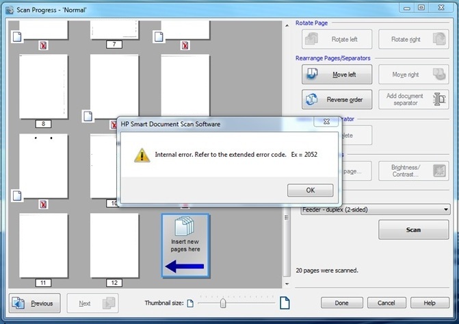

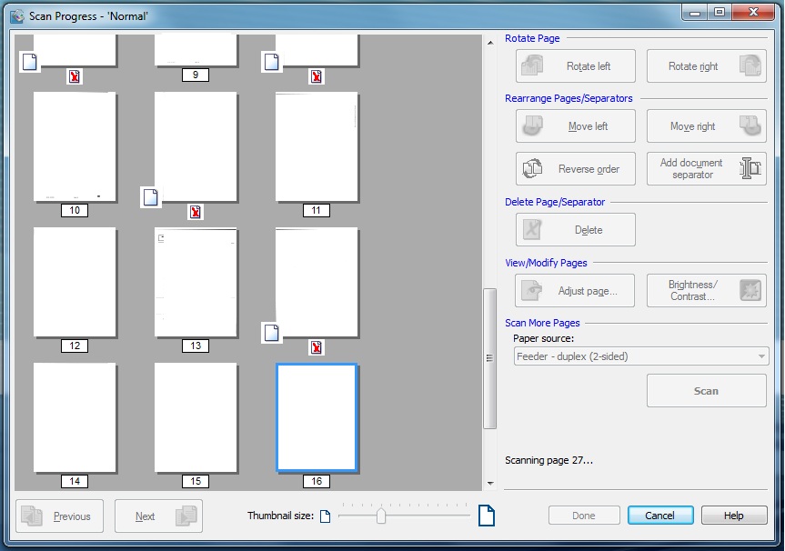

Here is a screenshot of error EX = 2052 and frozen program. Note in the second picture in the lower right it says "scanning page 27..." indicating that the program is frozen in the middle of a job unlike the top where it stopped and gave an error code.
I was scanning actual pages but covered the content.
Ex = 2052 used to occur a couple times a day but I now rarely see it but it popped up twice today.
The second is the error that occurs every 250 pages scanned.
