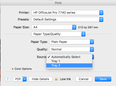

We can change the source settings to Tray 2 from the print dialogue box. Here is how to do it:
1.) Open a document, click File, and then click Print to open the print dialog.
2.) If a Show Details button displays at the bottom of the dialog, click it to reveal all available menu options. The button changes to Hide Details when clicked.
3.) Click the Un-named menu and select Paper/Quality.
4.) Click Source and select Tray 2.
