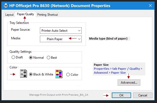

Thank you for the list of compatible media types, the cardstock that I'm attempting to use is included in that. However, I'm still unsure how to select the cardstock to use. I'm using Windows 10 and printing from adobe acrobat if that helps.
@jlbeck13
I do not use Acrobat:
How-to-print instructions are likely available in your Acrobat software in the Help tab.
I can offer the following to help you resolve the "how-to":
The following example applies to Adobe Reader DC  .  The setup is likely similar.
Open the file in Acrobat Reader DC
Click Print icon
  1. Media type (kind of paper) is set in Properties > tab Paper / Quality > Media
  2. Size of Paper is set in Properties > tab Paper / Quality > Advanced > Paper Size
General Example (ignore the settings for Black and White)
