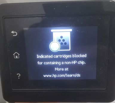

My Color LaserJet MFP M281fdw, all the sudden yesterday Nov. 30th, printer popped up with this message and has become utterly useless.  Need fixed ASAP.
Also should note, running newest firmware 20211109
If this helps, the HP App Utility is mentioning something about a lack of connection to the internet.  Is this an issue with validating cartridges through HP's Servers?  See image.
Should also be noted my validation is turned off in settings.
UPDATE
Wanted to post a temporary solution here so people don't have to dig through this post... I would suggest contacting HP directly through phone to get them to change this ridiculous policy.  It is indeed intentional as shown in the firmware notes on their site and I can't believe this company would do this...
Follow the steps outlined in this reddit article
https://www.reddit.com/r/printers/comments/jpgpp3/hp_laserjet_pro_m280_m281_printer_series_20200612/...
If your printer is on your network (either with a physical cable or on WiFi, you should just have to run the exe, select your printer and click Send Firmware, then wait..  After the awakenchurch_0-1640633552396.png icon appeared I did go physically power cycle the printer, and a few minutes later it started the firmware downgrade on the printer itself.

My Color LaserJet MFP M281fdw, December 1st, printer popped up with this message "indicated cartridge blocked for containing a non-HP chip"  and has become utterly useless.  Need fixed ASAP.

I have been working on this stupid issue for two days now but I'm happy to say I finally fixed it!! You need to downgrade the latest firmware update, search it on Reddit
Yes, actually one of the prior posts was exactly that with the download link as well for the earlier firmware version. You can see it on page one.
The firmware downgrade worked for me as well on 4 of my 281 printers, the other two have not been affected yet, but only bc they are not 281's, therefore I'm sure the next firmware update will ruin them as well, although one is an inkjet.
BTW, for those of you with wifi connections, if you use the link provided from the earlier reply on this post, you will need multiple attempts to downgrade the firmware. It may not even work at all. If that's the case, just connect via ethernet cable or directly via USB cable. If you do, remember you may need to re-add the printer as your computer will recognize it as a different printer device. After you're done you can delete the newly added printer and go back to using the wifi (remember to turn off the wifi in setup or settings when using a different type of connection before you connect the printer to avoid conflicts).
You may also get stuck on the "programming" status screen on the printer itself. If it still says "programming" with the flashing status bar for more than 20 or 30 mins, simply turn off the printer then disconnect the power cable for 10-15 mins.... All will be resolved.
