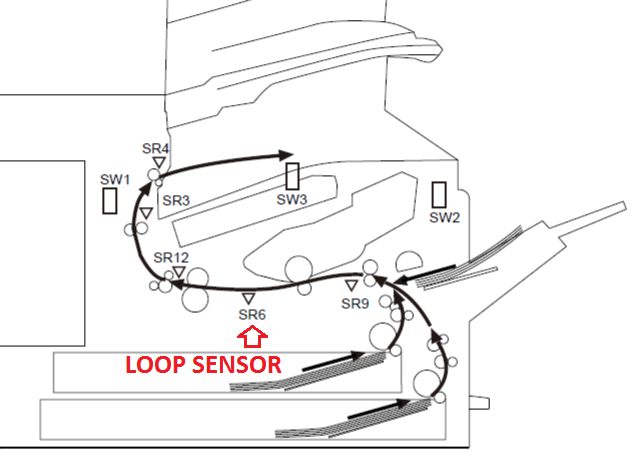

My customer has a new printer as indicated and am getting a random 13.B4.FF. Loop sensor PS9. I cannot locate it based on the service manual. Anyone out there can show me with a Pic please?

- Open the cartridge door, and then remove the toner cartridge..Between Registration aassy & Fuser assy you can observe loop sensor...
snap,..
.........Rest youcan do,best of luck..
Thank you but what you show does not look like the LJ M806DN, replacement for the LJ 9000 series. PS9 not PS6. I do know there is a sensor just before the fuser but it is not shown in the manual. I will compare the part I ordered to what I see in hopes that is what it is. Thanks again.
