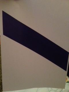

04-08-2015 02:31 PM - edited 04-08-2015 02:34 PM
Hello again,
I did finally manage to get two prints done.
The first with the single stripe was from the result of running the cleaning function. The other photo was from a demo page.
The prints were after following all the instructions you said and also after going through the instructions on the link you sent. These were the only two times I've been able to print. I haven't manage to print anything else.
Any ideas what I can do now? Thanks in advance.
Shev
04-08-2015 03:31 PM
Hi tshekedi,
Thanks for providing that information and the pictures.
The cleaning page looks right, but the Demo page should be darker in color, yours is really pink.
What color is the mark on the page from the cleaning page? It should be black.
Are you using Genuine HP Toners?
Try and print from the computer in color to see if you have the same results, it may be a issue with the black toner.
Let me know the results of the Diagnostics and Print Quality pages from the document. It would be great if you can provide a picture.
Please let me know so we can figure this out and what operating system are you using so we can also troubleshoot the software.
