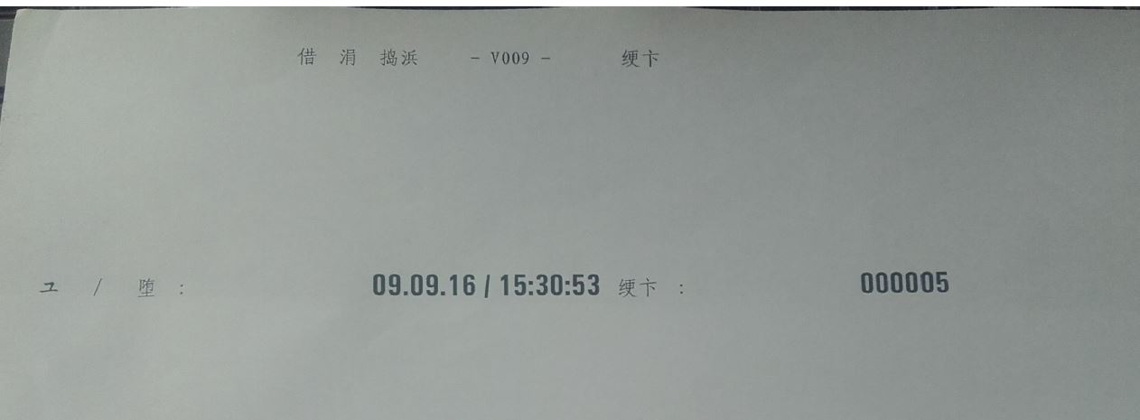

Hello, I have a HP Laserjet P3015d and I acquired the Chinese font module for Asian fonts from HP.
My OS is Linux is: SUSE Linux Enterprise Server 11 SP3 (x86_64) and I using cups for printing.
At the moment I'm having problems because when I'm trying to print Chinese text ( Simplified Chinese), other Chinese text is being printed.
This is which my print file contains:
^[&l1O
^[&l26A
^[&t38P
^[(18C^[(s1p12v4s0b37366T^[(s0B^[&a1417H^[&a0V****** - V009 - 未知箱号 ^[(12U^[(s1p12v4s0b4148T^[(s0B
^[(18C ^[(s1p12v4s0b37366T ^[(s0B^[&a0H^[&a1417V日期 / 时间:^[&a1984H^[&a1417V^[(12U^[(s1p18v4s0b4148T^[(s3B09.09.16 / 15:30:53^[(12U^[(s1p10v4s0b4148T^[(s0B ^[(18C^[(s1p12v4s0b37366T^[(s0B^[&a3401H^[&a1417V箱>号:^[&a4818H^[&a1417V^[(12U^[(s1p18v4s0b4148T^[(s3B000005^[(12U^[(s1p10v4s0b4148T^[(s0B
* I have susbtitued the company name which was printed by ****** but other Chinese fonts are exactly the same.
However this is how it's being displayed:
Any idea why wrong Chinese characters are being printed?
Many thanks in advance.

09-12-2016 06:45 AM
I don't have enough information to be able to guess at the cause of your problem.
I can't yet see your image of "how it's being displayed" - these images may take a number of hours before they are "approved" and available for viewing.

09-12-2016 08:09 AM

09-12-2016 08:18 AM - edited 09-12-2016 08:24 AM
For those four glyphs, the UTF-8 representations (where '0x' just indicates a hexadecimal value follows) would be:
0xe69caa
0xe79fa5
0xe7aeb1
0xe58fb7
If you are actually passing in UTF-8 encoded strings as per above, then you should probably:
- Select Symbol Set 18N ("Unicode") instead of 18C ("Simplified Chinese").
- Use "Text Parsing Method" 83 ("UTF-8") instead of method 38 ("1- or 2-byte Asian 8-bit").

I finally were able to print the chinese characters with this format:
^[&l1O
^[&l26A
^[(12U^[(s0p5h0s0b4099T^[(s3B
^[(18C^[&t38p^[(s1p12v4s0b37366T^[&a1700H^[&a708V******** - V009 - ÌõÂë¶ÁÈ¡´íÎó
^[(18C^[&t38p^[(s1p12v4s0b37366T^[&a850H^[&a1417VÈÕÆÚ / ʱ¼ä: ^[&a1984H^[&a1417V^[(12U^[(s1p18v4s0b4148T^[(s3B16.09.16 / 08:41:38^[(s0B
Where õÂë¶ÁÈ¡´íÎó is how is converted the Chinese characters when I convert from UtF-8 to GB2312 encoding.
Main problem here is that when I tried converting before to GB2312, the conversion wasn't done properly.
Many thanks
09-16-2016 03:01 AM
Good that you've now got things working on your system, using the Text Parsing Mode 38 ("Asian 1/2 byte") setting, with GB2312 encoding of the two-byte values.
Your PCL is (strictly) invalid, because the (two instances of) <Esc>&t38p should be <Esc>&t38P (since in each case they are the last or only contiguous sequence with the same root).
