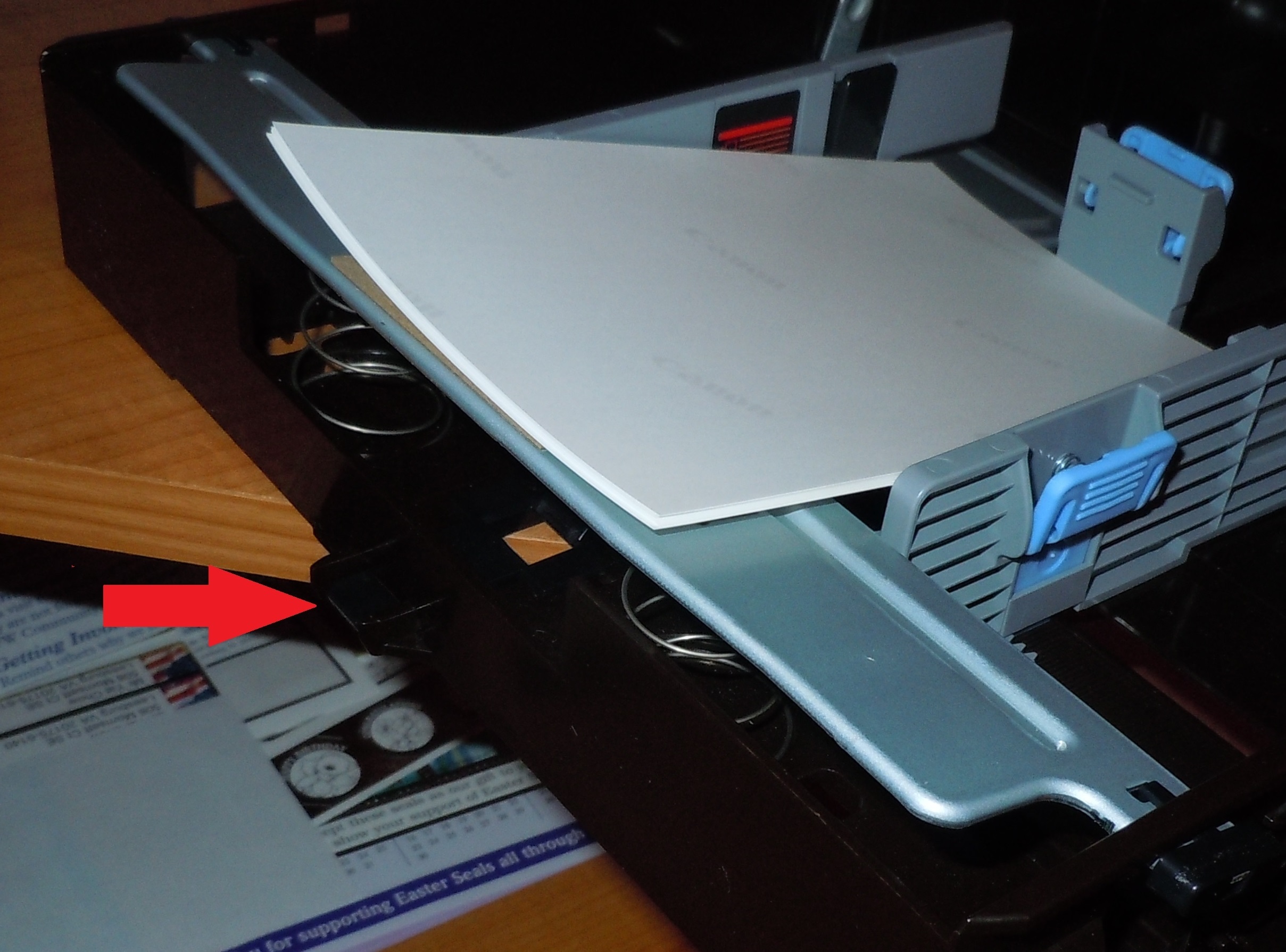

I was having the same issue with my brand new 8600 Pro printer.  At one point I have as many as 200 photo paper but the printer still not able to feed the papers.  By accident, I bumped the button at the front of the tray and the front bracket pops up. Looks like this spring board like bracket supposed to pop up when inserted.  So I pop it up, push it back down, repeat couple time to make sure it is not 'sticky' anymore.  I insert the tray into the printer slowly and wait for the 'click' sound indicating the spring loaded bracket is poped up.  Now, I am able to feed photo paper into the printer; I have only few sheets of photo papers and the printer has no problem feeding it now.
Push the button at the front until the spring pushes the bracket up. Note that the paper is tilted upward for easy feeding.
Tray with spring board up
