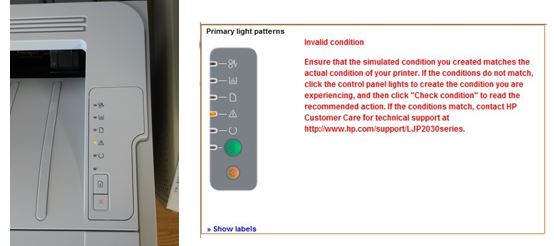

I have seen this fault on 2 HP p2035 printers.
After fitting a new genuine toner cartridge the printer shows a constant error , solid orange lamp by the  ! symbol.
When I check this error code in the utility it says Invalid Combination.
When connected to PC device manager shows Unrecognised device.
I have tried factory re-set & re-installing drivers, no success.
Any help would be appreciated.

Hello @AllanW
Here it is the explanation from the error on this light
Manual Feed or Continuable Error
This state can be reached in the following
circumstances:
● Manual feed
● General continuable error
● Memory configuration error
● Personality/Job related error
To recover from the error and print
whatever data is possible, press the Go
button.
If the recovery is successful, the product
goes to the Processing Data state and
completes the job.
If the recovery is unsuccessful, the
product returns to the Continuable Error
state.
Just to confirm the reset you perform it will need to go like this
For HP LaserJet P2030 Series Printers, restore defaults by pressing and holding the Go button
and Cancel button for 10 seconds while turning on the product.
Off course since its a new toner you want to make sure that you pull it out and make sure that you have no shipping locks or materials usually orange color
The problem may be with the toner so you want to make sure that you try a different even and old one to see if the situation persists
