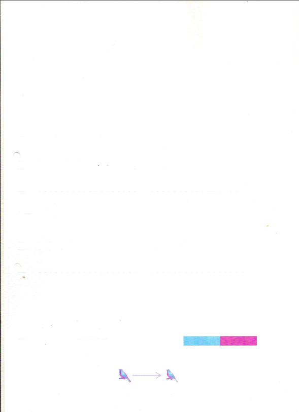

After few years I again tried to use my Photosmart C6180 printer. I bought new cartriges. Everything looks good but when I try to print, the printer push out just blank page with nothing printed.
Yet I tried some reseting suggested here on forums, factory reset, multiple printhead cleaning but nothing helped. When I tried to print self-test page, it also gave me blank page.
Finally when I tried to align the printheads I get something on the paper but it is not proper result I think. See result below. Moreover error occured on printer display that align wasn't successfull see the documentation or something like that.
Than I also tried to print extended self test from report menu And I get one page with blue rectangles. Than next page goes out but blank and display says that printing was cancelled.
Please can you guide me to make my printer print properly again?
Thanks.
Result after printhead alignment:
Result after printing extended self test:

The Photosmart c6180 has permanent printheads and plumbing to connect to separate ink supplies.  Storing the printer for an extended time period can allow air to be ingested into the plumbing, and the ink may thicken.  Running three levels of cleaning cycles may improve things, you may need to do this, wait an hour or so and repeat the process several times.
I do not know if you will be able to recover the missing colors, it is worth a try. See the document here for information.

I tried another cleaning cycle and now also black color is printing. but still 2 colors are not printed and one has poor quality. Hopefully after few more printheah cleaning cycles it will run again well
It sounds like some progress.  If the colors are gradually coming back the printer may recover fully over time.  HP generally recommends printing once a month to keep the printheads from clogging.
