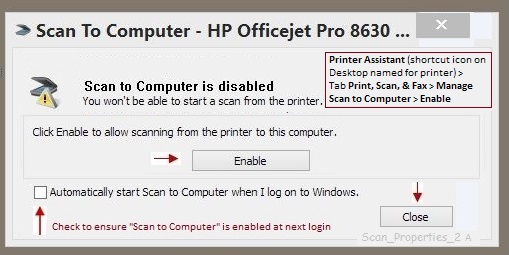

If you are trying to scan from the printer to the computer, be sure that Scan-to-Computer is enabled.
Printer Assistant shortcut icon on your desktop (named for your Printer) >
Print, Scan & Fax > Scan a Document or Photo

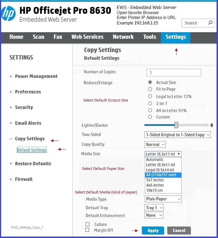

For the Copy:
A 'Scanner Failure' Message Displays on the All-in-One Control Panel and You Cannot Scan, Copy, or F...
Copy Settings:
