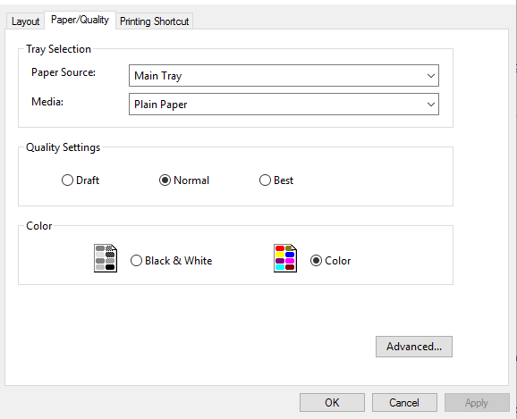

If you are able to make a copy in color, please follow the procedure mentioned below to check the printing preferences to color.
Open Devices and Printers from the control panel.
Right-click on the printer icon and select Printer Preferences.
On the printer preferences window that pops up, select the Paper/Quality tab.
In the paper/quality tab, make sure the color option is selected.
This should resolve the issue you are facing. Also, refer to this HP Article if you want to print in black only.

Thanks so much for your help. However, I'm still having a problem; when I click on the Paper/Quality tab, everything is the same as in the screenshot you posted, but the Color option isn't there at all, which is strange. What else can be done?
