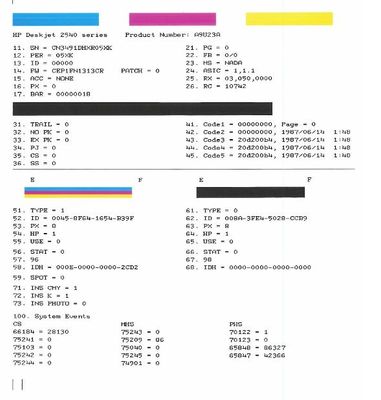

Hello,
Please try the below steps to print the Diagnostic page, and check if the TEXT in Black  and the color bar on the right is also in Black ( solid black ) without having any white streaks.
Below is the photo of a Diagnostic page.
If black as in the above picture does not show up, then it could be either an issue with Black Cartridge or the printer itself.

The photo of the diagnostic page you sent looks quite different from the 'Quality Diagnostics' page I referred to earlier.
So, I went searching for alternative 'diagnostic'-named  pages.
In the 'HP Printer Assistant' for my Deskjet 2540 All-in-One, in the section 'Print', I found  'Maintain your printer - align and clean ink cartridges, print a diagnostic page'.
In the subsequent menu, the first item ('device services') offers as one of four options the possibility to print-out a 'Print quality diagnostics page'. That's the one I already had tried (and which shows those 2 pairs of well-printed black brackets at aprox. center page).
The 2nd item in the menu, 'Device reports', shows two options.  The first one is 'Print diagnostic information'. Bingo !
That clearly is the one you sent a photo of:  on top of the [ portrait form ] page on one line 3 short separate horizontal bars of the 3 colors, and further about halfway down on the left side one horizontal bar composed of all 3 colors together.
BUT:  in my print-out of THIS PAGE that is all:  there is NO BLACK, apart from a few very  minimal traces of some lines between those 2 sets of color bars.

Hello,
Hold Power Button and Cancel button together for 5 seconds and release them.
The printer itself should start to print the extended diagnostic page.
If you dont see Black ink as mentioned in the picture in earlier post, there would be 2 possibilioties.
1> Ink cartrdge , if so you may try using another black ink cartridge. ( If you have already tried with a spare black cartridge go to step2.
2> It could be issue with the Printer . You may have to call HP Tech Support for further assistance (USA) 1-800-474-6836
