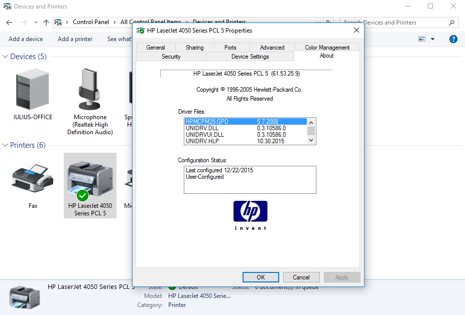

I installed upd-pcl5-x64-5.9.0.18326.exe that worked before on Windows 7 & 10 64-bit. Now I get that the printer is in an error state or error printing on HP LaserJet 4050 Series. I tried many drivers and no one working. The printer is connected to the PC by LPT1.
How can I get my printer working?
There are known issues with Windows ten and lpt1.
Open device manager and find the settings for the LPT 1 port and look for a checkbox to tell it to use any available interrupt.
I wish I could be more explicit but I've only read about this fix on another dozen or so older LaserJets.

Great, now works. Many thanks for the solution.
