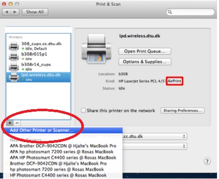

Check the driver name that is installed for the printer. Make sure it shows just the printer's name.
Click the Apple menu and then click System Preferences. Click Printers & Scanners, highlight the printer name on the left side and on the right side of the screen it should show the printer's name. (Color LaserJet Pro MFP M177fw)
If the full printer name isn't listed correctly, delete it and add the printer name back in from the list. Click the - sign to delete the driver and then click the + sign to add the driver, might have to click the drop down to select the printer's name to add it in.
Here is a screen shot of what it should look like. Do you have the Scan tab across the top?

Hi @sa9494,
I see that you are having issues scanning. I will certainly do my best to help you.
