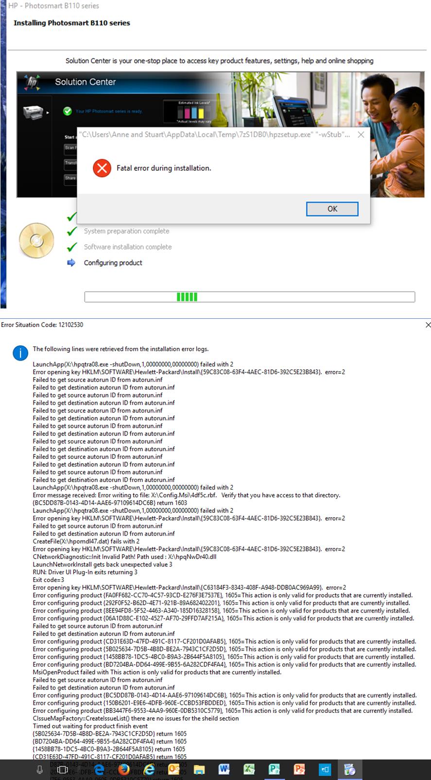

Once it reached the configuaring stage it took 10 minutes before it reported the fatal error. I took a screen shot of the partial error log, but I do not know where the whole log is stored.
HP Instal Error wizard 8.hta was then installed.  I ran that and the HP printer Wizard which kpet going in circles first finding the printer and then going back to a blank screen.
When I checked the system again the printer was installed but the Solutions Centre still does not work.
Once again the scan Doctor found TWO printers of the same name - one networked the other not. After the scanned was tested a couple of times this error was given.
Hope this helps.

@Dvortex  Thank you for the othe suggestion but that did not work either.
The same happened.  10 mins into configuring  it gave a fatal error.

I did change the compatibility to W8, but it gave the message that said it was not compatible with W7, hence why I then changed the compatibility to W7.  I followed all of your instructions.  I have downloaded the most recent  software and drivers from the HP site several times last week just to make sure.
I have been playing around myself and looked at the error message to try to work out what it was saying. Part of the error message stated it could not access a certain Reg key.  When I looked that was pointing to the D drive, so I changed that to C drive.  Same result.  I then took a risk and deleted all the Reg settings for HP, as well as all the software and drivers, and the temp drive where the installs where located.  Still did not solve it.  That time one of the error messages was something about it was for installed software only, probably because the install cannot access whatever it is trying to access initially.  BTW I did all of this with the anti virus turned off, so that is not affecting it either.
