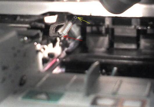

Okay, that springs goes on the left side of where the cartridges stop to replace them. With the printer on, unplug the power, then open the ink access door. If the ink cartridges are on the right, slide the assembly to the left out of the way. On the left side of the 'ink opening' is where the spring goes. Refer to the attached image. I would put the back loop on first with a pair of tweezers or forceps. The tab is located under the cross rail (yellow arrow) and is very hard to see. I would put it on first since it looks to be the hardest. Then put the front loop on the black plastic arm (red arrow) and that should do it. These are tiny locations, so it will require a little effort. The loops on both ends appear to be the same, so there should not be a front or back to the spring itself. Good luck.

Your explanation was very detailed, but the spring you're describing is still in place! Mine is a different spring, but I think it's the exact same size as the one in your picture.
It's specifically my blank ink cartridge (on the right) that won't register. I looked for a similar spring to the one you showed me on the opposite side of the ink cartidges, but I don't see any logical place for the loops to latch onto...Any other ideas?
Wow, those are the only visible springs that I know of in that printer. Anything else would probably require some disassembly of the unit. If it is still under warranty, I would contact 1-800-HPINVENT. Otherwise, look or feel carefully  (WITH THE POWER OFF) around the ink cartridge area to see if there is some sort of spring on the color cartridge side that is missing from the black side. Maybe on the back side of the printhead assembly. Good luck.
