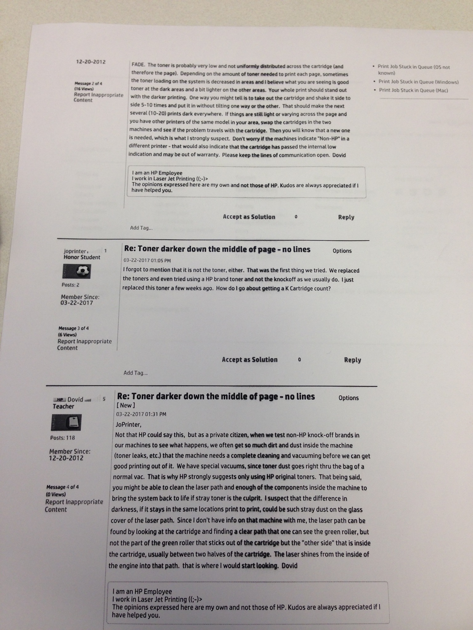

It doesn't happen on every print job but we are getting darker toner in the middle of the page - NOT lines, it's darker on the edges and the middle.  printer problems(a little hard to see in the pic, but the last few letter of "services" and half of "rendered" are darker, along with "Very" and "Jamie" towards the bottom.  Before you ask, please know that we have tried EVERYTHING we can think of.  This is only happening on 2 printers in the office that are on the same side as each other.  The buidling has tried replacing the electric wires, the data ports and we have tried everything from replacing the fusers to a complete maintenance kit and replacing the toner.  It does not happen on every print job, it can happen once and then not happen on the next print.  We need answers!!  our IT department is stumped!  please help!

i checked the toner and am not able to access the inside - I can see it - and the green roller looks clean as can be.  I understand that using the non-HP toners is not ideal, but that is what our company wants.  We have had complete service and cleaning of the printers, but I don't know if our service guy has the special vacumm you speak of.  We are puzzled by the fact that this is only happening on 2 of our 5 printers in the office - with the two trouble printers being on the same side of the building.  All of the printers are the same age and all use the Non-HP toners.  That is what prompted the electrical supply investigation and subsequent new electric wiring and data ports.
If this is the case, I would think it would print like this all the time and not just some of the time.  Is it possible that it could be a problem with Word?  Seems to do it more when printing from Word.
never mind my word comment - just when I think I can narrow it down, it surprises me.  I've attached our printed IMG_1293.jpgconversation
Sorry I may not have been clear.  Looking at the cartridge was only to FIND the laser path.  The laser and the glass to clean (or to have your service person clean) is in the machine but has to shine down into the cartridge while it is in the correct position in the machine down that slot that you found.  The page to page and time to time variation can have many answers and causes.  Basically YES - even if dirty, depending on the image, the areas that block the laser are most of the time may not show up.  Thus, on a page with 2 or 3% coverage like office documents, the spots on the page that might be dirty or dusty would be down the page in dirty and dusty areas in bands of lightness.  Often they might not be seen unless the cartridge is low on toner, since calibration often compensates.  Dovid

I still think it is a printer problem, not word or electrical wiring, etc.  Wow, by the way, it is worse than I have seen in many, many years of laser printing work.  I still think it is a dirty laser path.  However, is it possible that those two machines are in direct sunlight near a window?  there is a science thing that happens with that green drum.  If it has lots of light on it for a long time, it can fatigue and cause different printing on the area that is exposed.  It can be exposed thru the machine covers and even deep in the machine if the light hits the machine the "wrong" way.  That would be interesting as a cause.  Dovid
