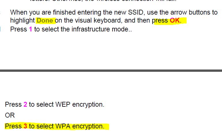

My modem was working perfectly with my 7410 printer, but a Verizon problem required me to reset the modem to the factory preset. I need to switch from WEP to WPA encryption.   My problem is that when I use the wireless wizard, it detects the correct SSID, but when I press OK it goes to the virtual keyboard and requests the WEP key.  The manual says to press 3 and it will select WPA encryption, but all I accomplish is the number three on the keyboard.  Can anyone help me?

After you enter your SSID (network name) scroll over to "done" and then press OK.
Then you should be able to press 3 and enter WPA passphrase.

Thanks for the suggestion.  I tried entering the factory (default) SSID and scrolled to done, then OK and it immediately went to the virtual keyboard asking for the WEP key.  I hit 3, and the letter D showed up.  I also tried entering the alternate SSID my Verizon phone guy set up (which worked perfectly until I had to reset the modem) and then the password key.  It tried to connect but failed.  Any other ideas...I'm about at wits end.
Donald, thanks for the help.  It occurred to me when I replied initially that Duke (the Verizon guy) changed the SSID and WPA key from computer to the modem/router.  I went into the settings on the modem and changed them and now it seems every things OK
