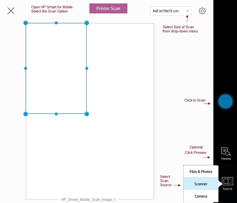

Following is an example of scanning an image and selecting Share.
Once Share is selected, Select to send the image via email to your chosen recipient.
In so much that I am aware, this does not use ePrint - uses your Default email and you can send to (I think) anyone else who have email.
Examples are from iPad Pro - iOS Version 13.4.1 - HP Smart Version 7.2
HP_Smart_Mobile_Main_Menu_3
HP_Smart_Mobile_Scan_Image_1
HP_Smart_Mobile_Scan_Image_Preview_1
HP_Smart_Mobile_Scan_Image_Options_1
