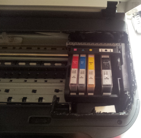

I managed to fix this problem! But it will take more than a little effort...:
0. Disconnect the printer from the Mains.
1. You have to remove (cut) the platic above the printhead!! I used a solder, it took much time and the smell was awful... But it worked. You have to remove two pieces of plastic "plate", one "above" the printhead and one "below" (below = towards yourself). Mind the "threads" that come out of the plastic when you melt it, so they don't get into the printer / printhead. (If you choose to use dremel, mind the dust!!!)
2. Take out the print cartriges
3. Take out the printhead
4. Below the printhead there is a "drawer". The printhead moves left-right, the "drawer" moves forward-backwards ("into" the printer). They are stuck together!!! Gently move the printhead, and try to figure out where these two parts are stuck together. I found two locations. With simple screwdriver, push the notches of the drawer, to release it, and then it moves "into the printer".
5. Move the printhead (left-wards) to the middle. Position the drawer so that it doesn't obstruct the printhead's movement.
6. Plug it in, and pray 🙂 I printed 200 pages, it's still OK, but I think that if it happenned once, it can happen again. Yet, so far so good.
Good luck!!
Eric

Eric's solution is effective, but for those of you who think his method is a little crude, there is a more elegant way to access the print mechanism.  Go to https://www.youtube.com/watch?v=CjqHFN-da8M and view the video showing how to remove the cover that gives you access to the print heads.  Of course, there is no guarantee that your problem is caused by the same problem Eric had, because in researching this "Print head stuck in right position" I found that there had been numerous causes, from broken pulleys, to parts that had fallen off, to a spring that had come off its hook.  But by being able to take the printer apart, as this video shows how to do, you might be better able to ascertain the real problem.
