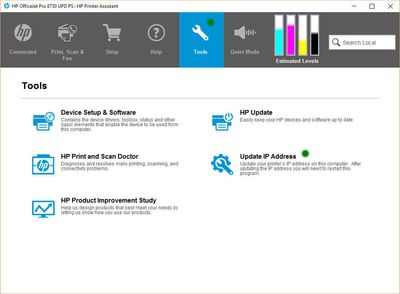

The  Utility actually has a feature to Update IP address, without the need for a new printer added.

The feature to change the IP address will be found in the Printer Software. You have carefully to read the link text before you click the link: After using the utility you have ro restart the printer software. The utility works, it changes the IP address but without restarting the Software it will not work. Would it not be better to move the instruction to restart the software after it has been used?

Hi @TJakober
Thanks for your feedback, the Utility we were referring to was that from the Printer software. Example.
Thanks.
