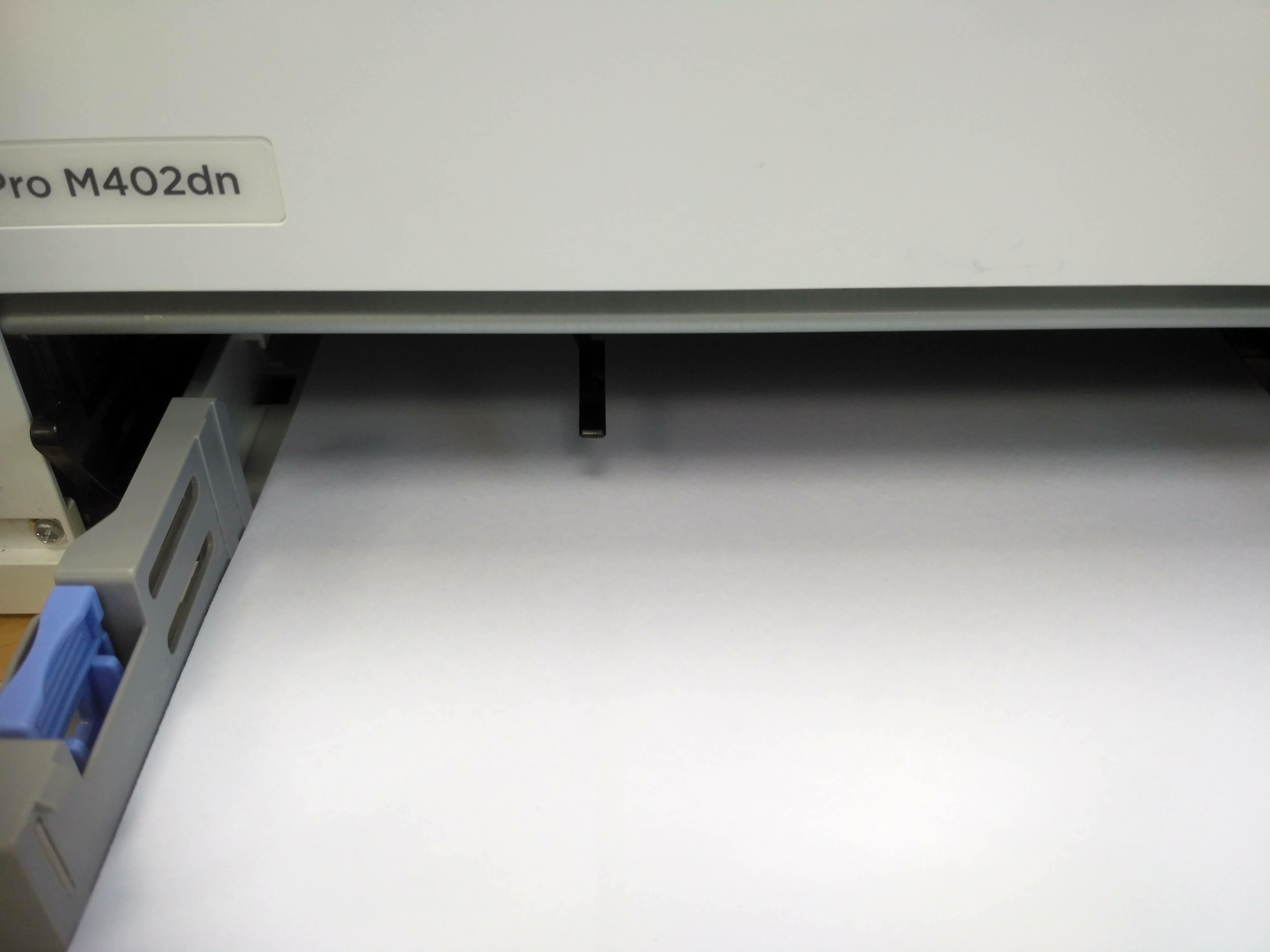

When I'm trying to print, it makes a sound of not able to collect the papers. I see there is a small black hook in tray 2, that I don't remember it was there before, so maybe it had a connection to the problem...

That part is probably the paper out flag and it should raise when the tray in inserted and the paper lifts up. Two things to check. Make sure the backstop on the tray is set in the correct postion. If to far forward it prevents the paper from lifting all the way up and if to far back the pickup roller can not grasp the paper to pick it up. I do not know how long you have had the printer nor how many pages you have printed, but if you have printed a lot of pages, check the condition of the pickup roller inside the tray cavity in the center front.

I think the backstop is also fine - what do you think? (see the pic)IMG_20170510_162528_HDR.jpg

I had the same problem.  In my case one of the clips holding the front of the drawer was broken causing the paper level indicator arm to come out of alignment. When this happened and the tray was less than 3/4 full the tray couldn't push the paper up high enough to be caught by the pickup roller. I just remove this arm and the jam errors disappeared.  I decided we can work without the level indicator rather than purchasing a replacement tray.
