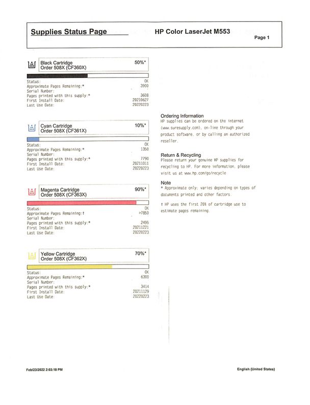

I am getting a thick band of streaking down the center of the printer.  How do I fix this?
I've scanned and attached below a page that was printed from a blank word document.

Cleaning page didn't work.
Here are the supply pages:
Hi,
How do I understand this?
The comparison of the images shows that the "thick streak" is no longer present on the Supply Page.
Only a small strip is still visible.
The status page is OK.
Has the printer been checked for toner residue?
