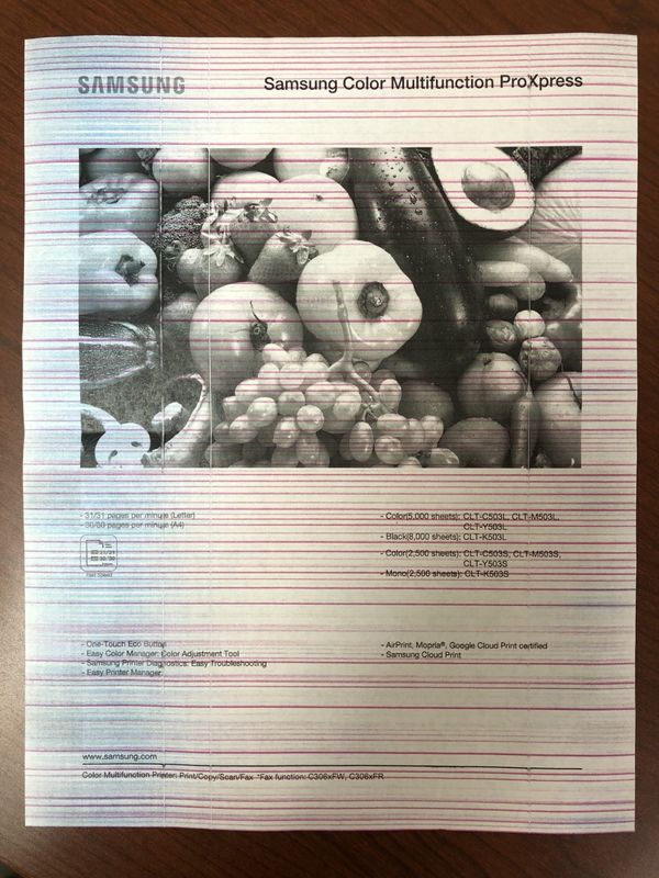

Here are examples of what prints out (I can't see where I can upload .pdf files, so I took photos of the printouts)
The first image is a test print from my computer to the printer.  The second image is a test print directly from the printer's setup screen.

Disregard my previous claim that the original cartridge worked with the exception of the damage mark... it currently has the same issues as the new cartridge - blue page with horizontal colored lines and black text behind.
So, this is where I am right now.  A beautiful new printer that can't print anything worth looking at.
