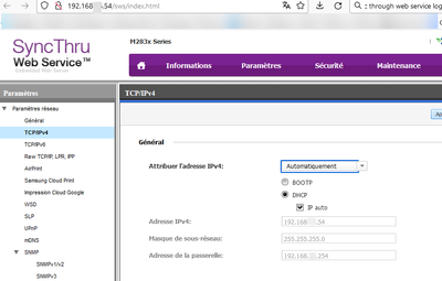

For a second try, I deactivated the DHCP and forced a new IP address 192.168.xxx.54
After that, I had access to the printer, on the network via its ethernet connection, through Sync Thru Web Service.
