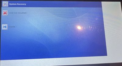

I also stuck on loading screen.
tried to recover the HDD from hidden partition without success.
HDD check is also not running.
Anyone any idea?

Finds "Samsung_C406x_Series_V6.00.07.02.hds" not on USB Stick:
Does not perform a health check on HDD:
Cannot do a "Log Backup":
Error indicates failed harddrive. You need to replace the drive and perform a recovery.
  1. Any suggestions for a replacement?
  2. And do you have an idea, why the USB stick is not recognized?
  3. May I have a wrong hds file?
Drive replacement can be any physical spinning disk, I have used ones at 500Gb, standard is likely 320.
Failed drive might prevent some functions from working. I am no expert on Samsung, but inherited supporting them when HP bought Samsung years ago.
Wrong file is a possibility.

Hi Repairtrooper,
exchanged the harddrive and now it is formatting the new HD.
I hope the rest will also be succesfull.
The old HD was not working anymore as I tried it in an USB to SATA Adapter.
I will report, if anything goes wrong or right.
BR
It started and now I have a machine with running FW...
