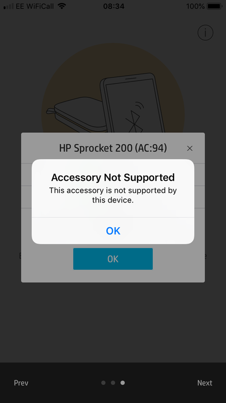

Daughter had this for Christmas. Downloaded sprocket app on iPhone 6 iOS 12.1.2 and get through all screens to select the sprocket then get error message to say accessory not supported by this device .
Bluetooth is enabled and it lists the sprocket as a device.  If you try to print it says you have to configure the printer by launching the app.
Tried turning phone on and off and deleted and dueliading app many many times but still no joy.

Tried your advice by resetting printer and this didn’t work.
Im not sure if I’m using the correct app as there is no menu option to be able to update firmware.2B3CE96E-DC9D-493F-82AA-2AB568B7F846.png
