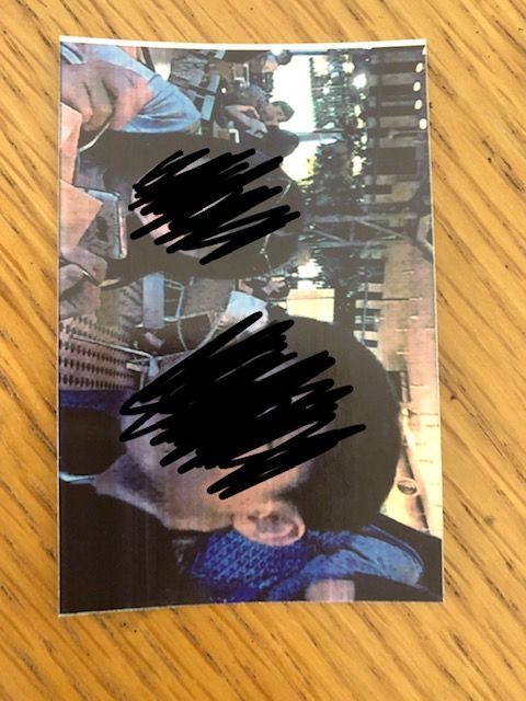

I just bought my sprocket 2 in1 and start printing the photo from my gallery. The photos turns out to be very low quality. worst than instax instant photo.please helpIMG_6898.jpg

Let's follow the below steps that could resolve the issue.
Step 1: Use genuine HP ZINK photo paper
ZINK makes custom photo paper for a variety of printers, such as Polaroid, LG, and HP. HP recommends using genuine HP ZINK Sprocket and Sprocket Plus Photo Paper for best results. HP cannot guarantee the quality or reliability of non-HP photo paper. If you do not use HP photo paper, the steps in this document might not resolve the issue.
To purchase genuine HP photo paper, go to the HP Sprocket homepage. You can also purchase HP photo paper through the HP sprocket app, and from other retailers.
If using genuine HP ZINK photo paper did not resolve the issue, continue to the next step.
Step 2: Upgrade the Sprocket firmware
HP regularly releases firmware updates. Upgrading the firmware might resolve the issue.
  1. Make sure the Sprocket is on and your mobile device is connected to the Internet.
  2. On your mobile device, open the HP sprocket app.
  3. Tap the Menu icon , and then tap sprocket.
  4. Tap Manage Printers, make sure your Sprocket is selected, and then tap Printer Settings.
  5. Under the Status section, locate Battery.
    • If the battery charge is 25% or higher, continue with these steps.
    • If the battery charge is 24% or lower, charge the battery for at least 30 minutes, and then continue with these steps.
  6. In Printer Settings, look for a firmware upgrade.
    • If a firmware upgrade displays, tap Get Firmware Upgrade, and then follow the on-screen prompts to complete the update.
    • If a firmware upgrade option does not display, the firmware is up-to-date.
Send a print job. If the print quality is still unacceptable, continue to the next step.
Step 3: Clean the Sprocket paper path rollers
Dirt and debris on the paper path rollers can cause print quality issues. Use the colored Print Quality Card (formerly the Smartsheet) from the same pack of HP ZINK photo paper currently in the Sprocket to clean the paper path rollers.
NOTE:
To avoid print quality issues, do not use a colored card from a different pack of photo paper.
  1. Remove the paper cover, and then remove any photo paper from the input tray.
  2. Check the photo paper and remove any severely bent, wrinkled, or torn photo paper from the stack.
  3. Reload the photo paper with the colored card on the bottom of the stack with the barcode facing down.
  4. Replace the paper cover, and then send a print job.
    NOTE:
    The Sprocket 200 automatically detects and prints the colored card when you replace the paper cover.
    The Sprocket calibrates and cleans the paper path rollers with the colored card, and then prints the photo.
Step 4: Other things to try
The following tips might help improve print quality.
  • Make sure images have a minimum resolution of 818 x 1258 pixels per inch (ppi) for optimal print quality. Screen-captured images from your mobile device might not have sufficient resolution for optimal print quality. See your mobile device manufacturer for more information.
  • Disable the Reveal feature on the HP sprocket app. If you enabled Reveal, the print job might take longer to print and print quality might be less than expected.
    For more information, go to Print Issues after Enabling Reveal.
  • Make sure the lighting is sufficient to clearly see the subject of your photo. Use the flash on your mobile device to improve the photo quality.
  • Use the HP sprocket appAutofixfeature. On the print preview screen, tap Edit or the Edit icon , and then tap the Autofix wand  or . The app adjusts the photo automatically. Tap the Checkmark to save the changes, and then tap the Print icon .
  • Use the HP sprocket app to adjust photo contrast and brightness. On the print preview screen, tap Edit or the Edit icon , and then tap the Adjustments icon . Adjust the brightness and contrast, tap the Checkmark to save any changes, and then tap the Print icon .
  • Allow the Sprocket a few minutes to cool down between print jobs.
    When the Sprocket becomes too warm, a cooling down message might display on the HP sprocket app. Allow the Sprocket to cool, and then tap OK to clear the message.
  • Store the photo paper in a cool, dry place and avoid contact with water. If water spills on the photo paper, wipe it away as soon as possible to prevent damaging the photo paper.
Keep me posted, how it goes!
