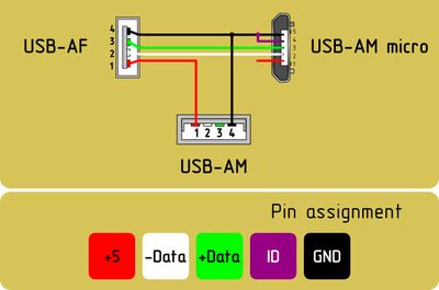

So how exactly did you make this cable? Was it like one of these diagrams?
Looking at the picture posted above (zooming in on it) it looks like the cable that worked was wired like your top diagram.
E.g. In words: Connect all 3 red power leads together.  Connect all 3 black 'ground' leads together.  Run the remaining two data lines (in kind) between the tablet data connnections and the 'usb data' connector.

I made the same cable  but soldered a 100k resistor and connected a 5volts 2amp adapter. Works perfectly, but if you connect 3 usb devices or more charging stops ( battery doesn´t decrease).
