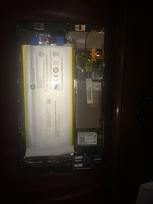

i have a stream 8 and I don't notice the issues you guys are describing with your 7's but I am familiar with it as the Toshiba encore 7 had the same problems... Out of curiosity from the earlier internal photos of the stream 7 and the missing antenna wires, I decided to open my stream 8 up to take a look. There are roughly 8 small Phillips screws and no stickers so I don't think there is any way to know that you opened it up.. You will notice in the photos, all of the antenna connections are used in the 8. The antennas are located on both the front, back, top, bottom and left side of the tablet. I hope someone finds these pictures helpful if not interesting!
Not sure if its just me, but i cant see your pics
i can see them when im logged out.. as for the picture quality, not much i can do. the reflective foil on the battery wreaked havoc on the autobrightness
I don't see the pictures either.
looked into it, they are awaiting approval...
hmmm.... maybe that explains why my 8 always works and the 7 can be problematic.
still not clear to me why disabling the 'acpi-compliant control method battery' makes the 7 work and has no effect ( network wise) on the 8.    the saga continues.
