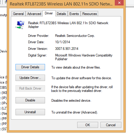

Could you post the version and date of the driver for your network adapter (REALTEK)?  Thanks.
I ran the HP Support Assistant, but it did not update any of my drivers.
Eric
me too, ran the assistant didn't see an update. fwiw/reference here's my current driver version Capture.PNG

Yup, same driver.

I have the same settings for my network adapter that you posted.
