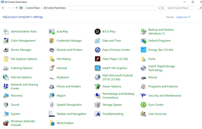

Thanks for your reply and options on troubleshooting my issue. Unfortunately, it didn't solve my problem. The touchscreen is still not working. I tried to look for the Tablet PC settings, but they're greyed out and not showing under the original "Control Panel" menu.
Control Penel
I was able to search the mapping - found folder but is greyed out.
I'm not really sure why this is happening. I thought maybe was missing drives or maybe firmware, all seems to be updated.
