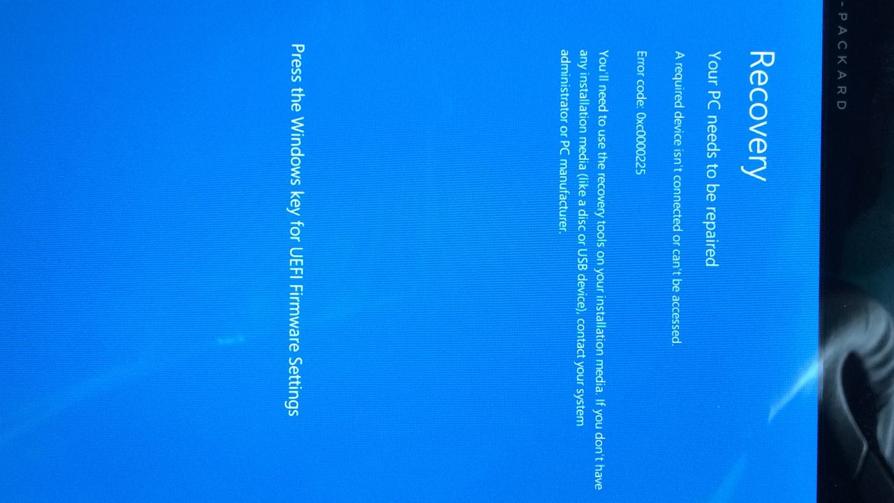

i can't reset my tablet by using system recovery as it showing Error code: 0xc0000225, and i'm not able to find any service center at johor bahru, malaysia.

at 1st, im using HP USB recovery disk, and i go to sytem mode press F9, it does show the USB and i select it, it start running it, but still showing error as pic i attached.
error for hp stream 8

got the reply from HP that the recovery disk (window 8.1) is not compatable from that error code. means still can't solve it.
Did the tablet possibly come with Windows 10 originally so that the Windows 8.1 recovery media will not work on it?  Did HP send you the correct recovery media?
