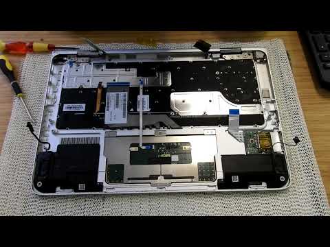

HP Spectre X360 keyboard replacement Please note this is not intended to be a tutorial but if it can help someone then Great.
