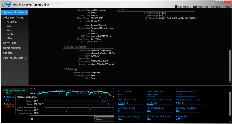

At exactly when my laptop CPU (i7 7th Gen) reaches 95 Degress Celsius ,both my CPU and GPU will stop working for a short period of time like (2 Seconds) i can see the graph drop and rise in Task Manager .
Drop in CPU & GPUDrop in CPU & GPU

 Attached Intel XTU Screenshot's for referenceIntel XTU Screen GrabIntel XTU Screen Grab
